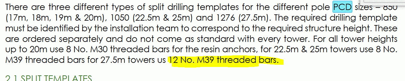

Manufacturers specifications require M39 anchors for a tower base plate, using HY 200 V3 + HAS U
I note the limit in software is M30.
Is there a workaround for this ? Other suitable tested products -post installation refers as concrete base is existing
HIT-HY 200 +HAS U for M39 anchors,Existing base
