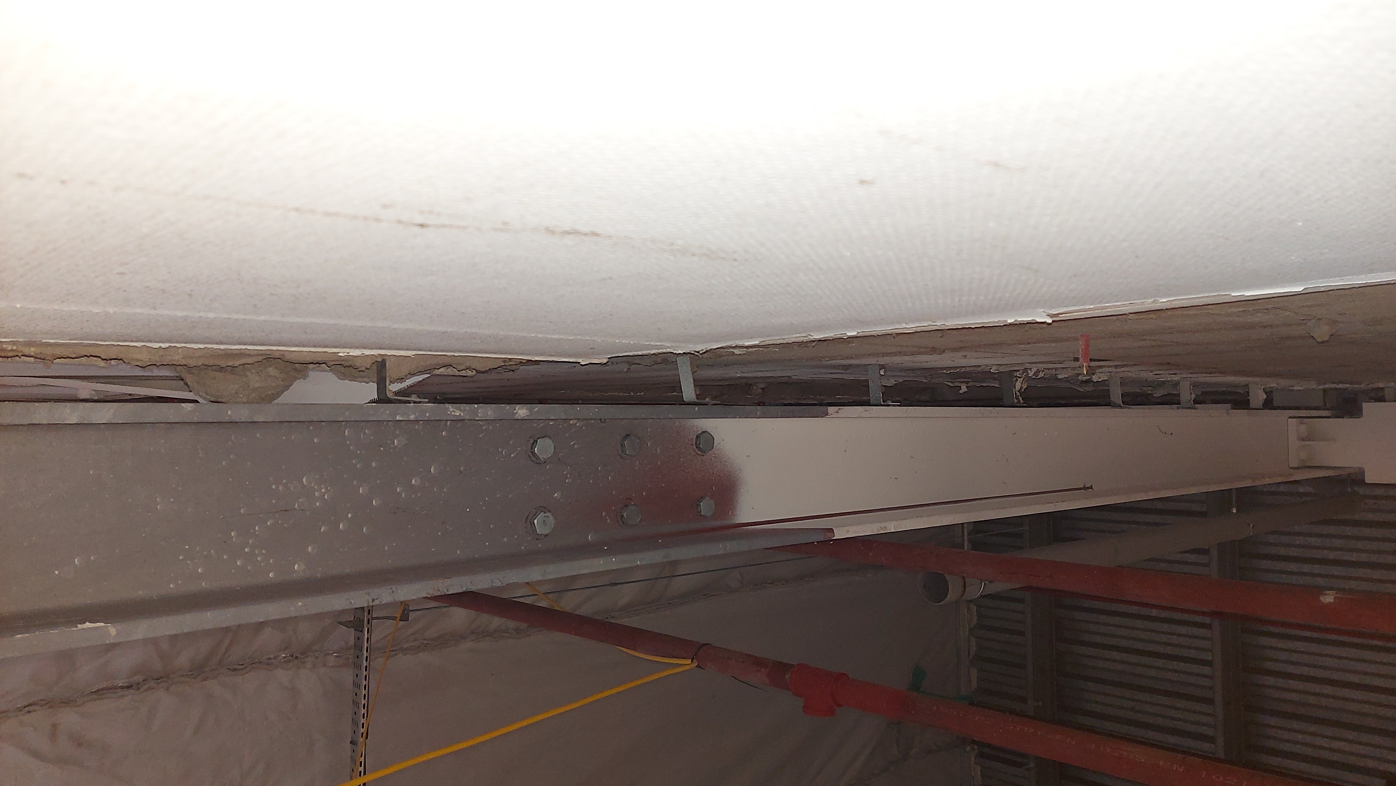

A warehouse is currently under renovation. Existing was ties between 190mm thick blockwork wall and steel column have failed. Please see the photograph below.
What fixing or system could you recommend for the replacement of the wall ties?
Column flange approx. 20mm. Wall to column varies (about 50 to 100mm).

Thanks for your question we don't supply remedial wall ties. If the wall is to be rebuilt then I'd suggest looking at the data for our X-QT system shot fired system . The cramp is attached via a premounted nail. I've attached a Link  to the GB website to a document for fixing cramps to structural steel sections for reference.
