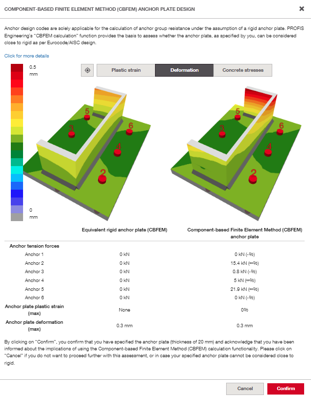

Why getting 0 anchor forces in Equivalent rigid anchor plate (CBFEM).
if there is no plastic strain in plate it can be assumed as close to rigid or rigid?
rigid,Close to rigid
Posted by Ask HILTI Teamabout 4 years ago
Thank you for your enquiry. Unfortunately, there seems to be an issue with your attached .pe file so I am unable to see your inputs. However, from your capture.png it would lead me to believe that your inputted loads are in compression from a combination of resulting moments and or additional compression. If you could either forward your PE file to your local HILTI office for confirmation or attach the long pdf report from your calculation for review.
