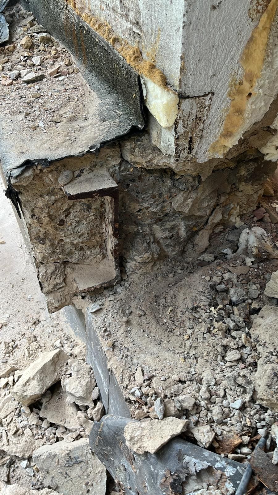

We have a concrete ring beam. at first floor level. Thers is a wall above and wall below. we did opening up works and found out there is a channel encased in concrete but it is offset from wall above. There is no reinforcement where there is wall above. and load along wall is in range of 36kN/m. So we would like some suggestion how we can reinforce ring beam at right position below wall position and connect it to off set channel.

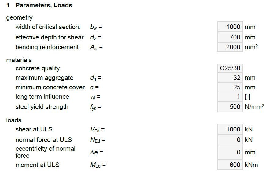

Thank you for your query, it might be possible we can assist by looking at linear shear strengthening as an approach. If you can provide the details in the screenshot below and email to gbteamstructures@hilti.com It can then be reviewed.
