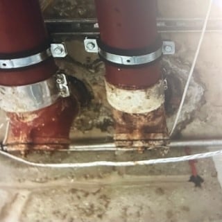

Hi All
We have a selection of fire collars which have been cast in concrete within our building. Over the last few years, we have had issues with water penetration from the mezzanine floors (pooling and general leaks to the basement area). Will we have to replace all of the pre cast units or will they still perform even though they are potentially water damaged? See photo uploaded. Thanks in advance for your response.
fire collars,Cast in
Posted by Team Ask Hiltiabout 3 years ago
Unfortunately, the CFS-CID collar does not have data for water permeability so we can’t comment in the product performance in your application.
