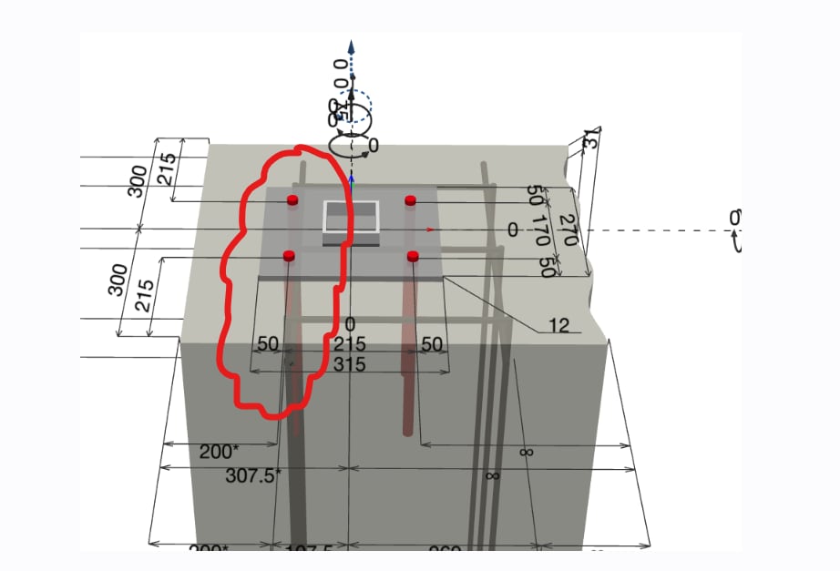

Moving Tension Supplementary Reinforcement in Profis Software
Is it possible to move the location of supplementary tension reinforcement in the Profis design software? It is currently clashing with an anchor location and I am unable to move it. Adjusting the spacing only moves it in the opposite direction.
Profis Engineering,tension reinforcement
Posted by Ask HILTI Teamover 2 years ago
Thanks for the enquiry, I'd suggest the easiest way is to input the supplementary details first then add the baseplate details otherwise as you've mentioned it can be difficult to adjust.
