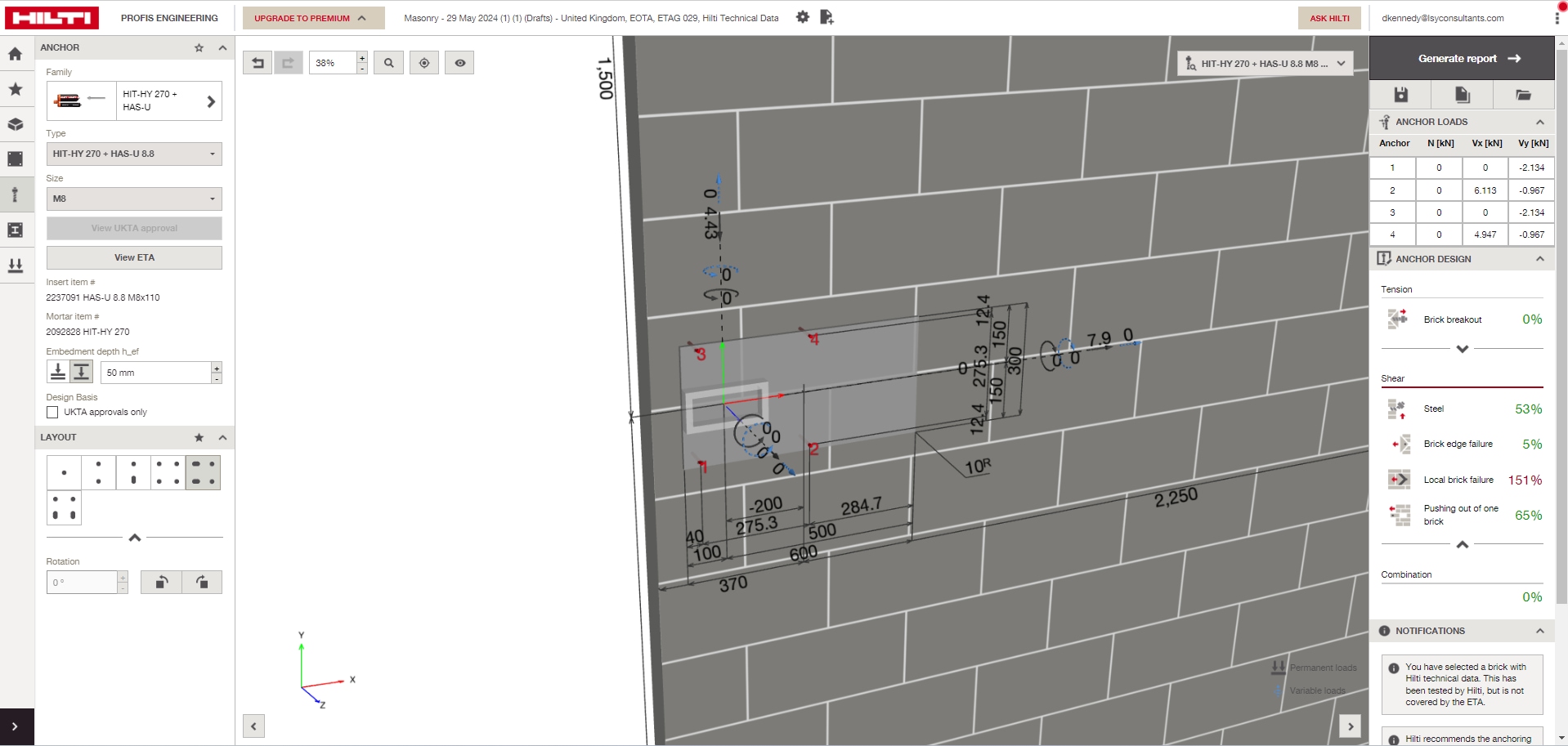

I am experiencing local brick failure. I believe this could be fixed by adding a bigger plate and more anchors. Can I not add more than 4 anchors in a masonry design using the PROFIS system?
See attached:
Thanks!

Thanks for your question, PROFIS Engineering follows the current design code for resin anchors within masonry structures therefore the anchor arrangement is limited to 1 , 2 or 4 anchor layouts with no option to customise outside of this criterion.
