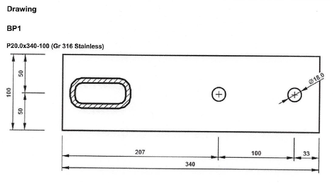

Can you recommend an anchor to suit a 65mm deep slab to take an ultimate load of 10.9 kN

Thank you for your question. The base material at 65mm depth is too slender and is outside any of our published data and approvals for post installed anchors. As a possible way of achieving a connection assuming that you have access on both sides,  you may want to consider drilling right through the slab and utilise a backplate however this design approach is outside of our remit.
