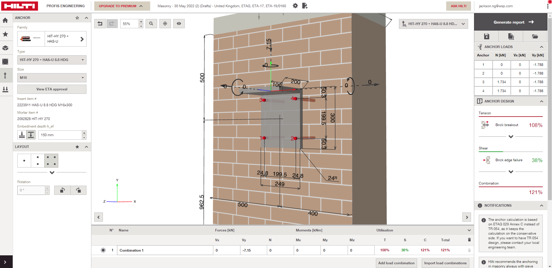

Can I anchor more than 4 bolts in the design of angle connection in masonry? I can only see max 4 bolts built in option
Masonry,Anchor Bolts
2 Replies
Thank you for your enquiry however the European Guideline ETAG 029 Metal Injection Anchors For Use In Masonry which the software follows for masonry design calculation process currently limits the anchor arrangement to 1, 2 or 4 anchors only.
