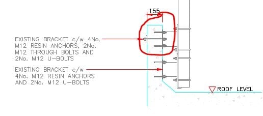

I have a report in which an assumed infinite dimension has been specified to reflect the connection being of a combined back plated and resin anchored bolts. Is the design check approach accommodated in the software ?

Thank for the question however Eurocode 2 Part 4  and subsequently Profis Engineering does not allow for a combination of post installed anchors and through bolting and back plating scenarios on the same connection with the latter no being a methodology that we could comment upon.
