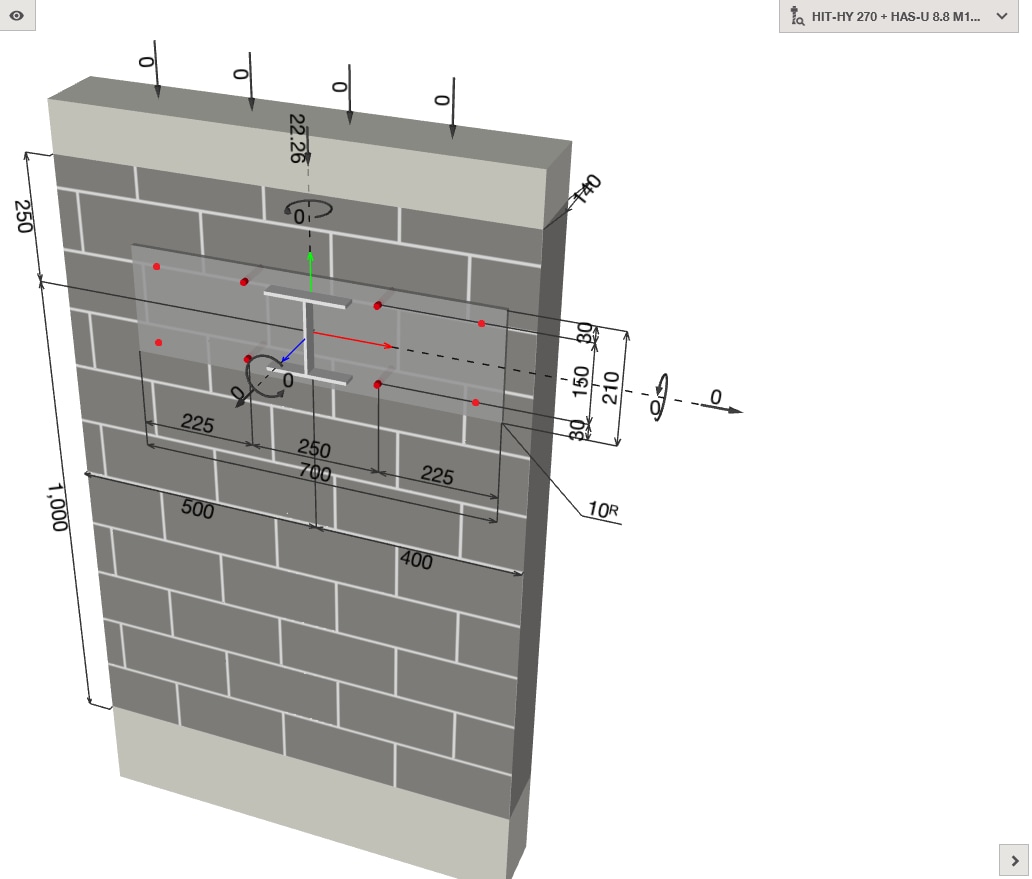

Good afternoon,
I need to check the situation presented below, where at least 8 or more masonry fixing anchors will be necessary.
Could you please advice me on that? How I can check it?
Thank you in advance!

Thank you for your question.
In the Masonry fixing part of PROFIS Engineering the anchors are editable according to what is defined by TR054. Single anchor, pair of anchors and group of four anchors in a rectangle. This is because a positive report from PROFIS Anchor always will have full support from relevant code. We are aware though that in some cases a solution like the one you are suggesting using more than four fixings may be required. Please contact my colleagues at our local technical office in GB for further discussion via gbtas@hilti.com
