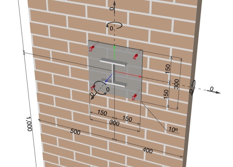

Posted by Ask HILTI Teamalmost 4 years ago
Thank you for your enquiry. The masonry module anchor arrangement is limited to 1, 2 or 4 bolt connection following the European design guidance. That being said you should still see and be able to adjust the spacing horizontally or vertically between a pair of anchors as per the screen shot below. Please not that you are not able to adjust single anchors within the group. I would suggest checking your region settings within the software ( The gearwheel icon) when you open the software and the sub masonry settings are activated then try and open a new model and select the predefined anchor arrangement and see if it shows you the dimensions that you can edit.

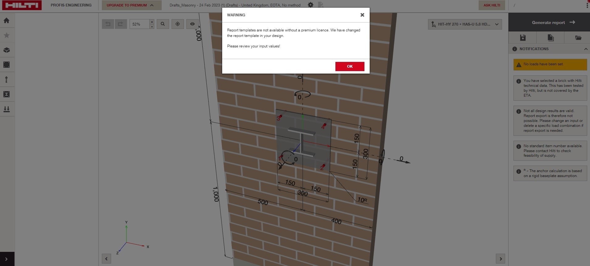

Posted by Rhydian Dayalmost 4 years ago
Thanks for sending this through. Unfortunately when opening the file it has made no difference and still will not allow me to edit or adjust the layout/dimensions of the anchors! See the attached screenshots. I would be very grateful for a swift response/solution.
Ok, I'm sorry that didn't help. One last thing to check is that you have the anchor dimensions activated. I've attached a screenshot below with how to access the sub menu via the 'Eye' icon from within the masonry module and with what I would typically expect to see activated.
1 comment on this reply
Thank you very much, that was the solution! I have no idea why 'anchor layout measurements' was unticked. Many thanks for your help
