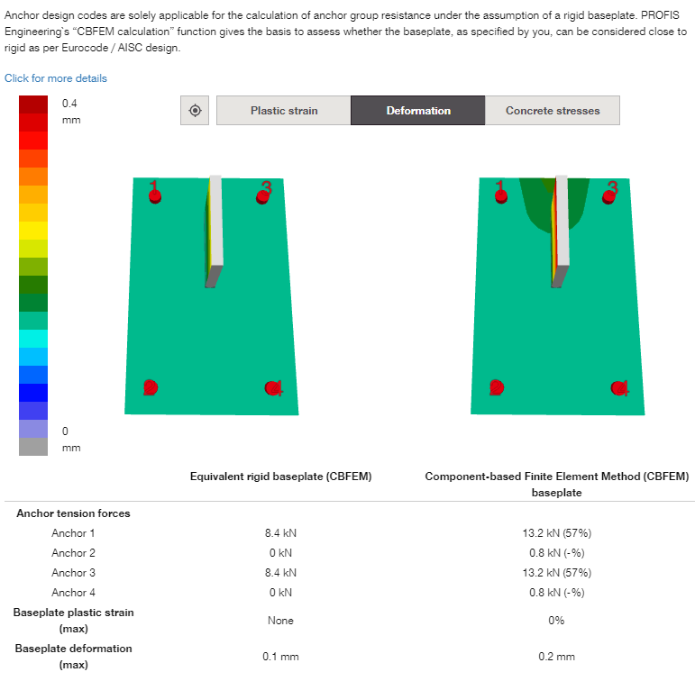

I have a baseplate which is calculated as flexible using the CBFEM method. This results in an increase in anchor loads of 57% which is above the recommended 10%, however all the checks still pass with the increased loads. What is the Hilti advice in this situation?
baseplate,flexible
Thanks for the question please refer to the attached link regarding the baseplate rigidity and associated factors in determining the criteria. https://ask.hilti.co.uk/article/how-to-assess-if-the-baseplate-can-be-considered-close-to-rigid-by-engineering-judgement/qass0a
