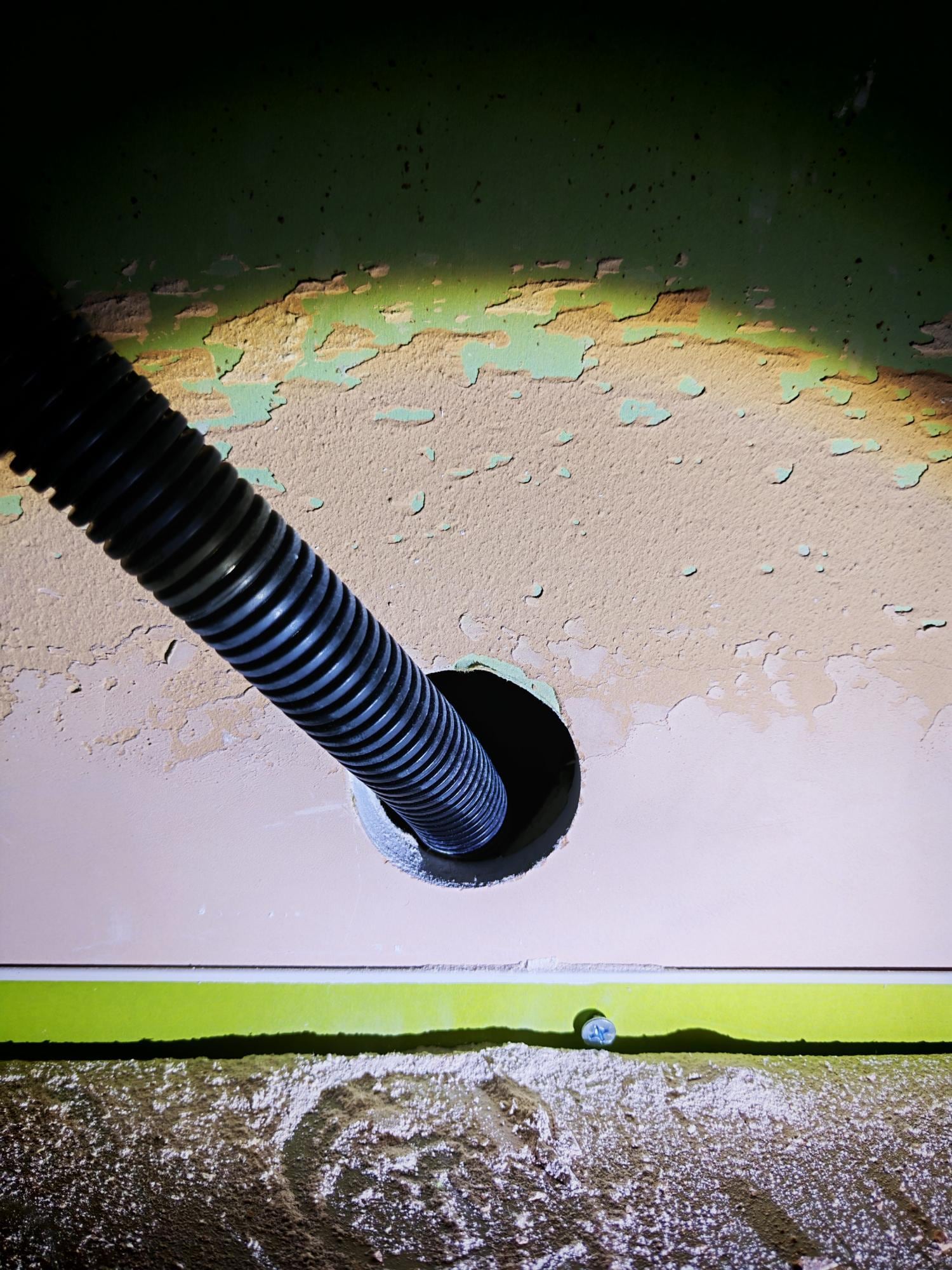

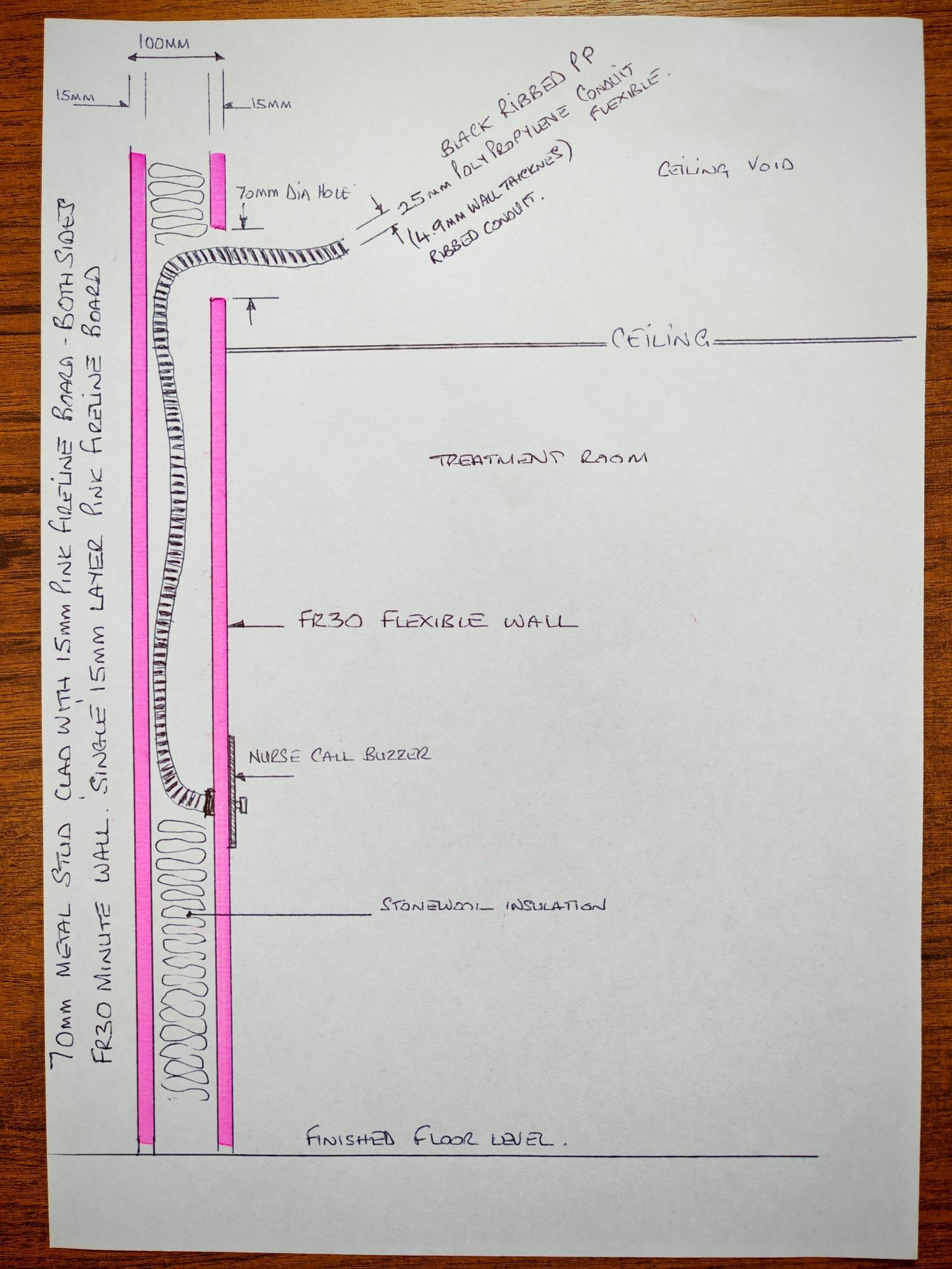

Can you offer a Firestopping Solution for the following Partial penetration.
FR30 Flexible wall 100mm
Comprising 70mm Metal Stud + Single 15mm Fireline Plasterboard each side
Stonewall insulation
70mm core hole made in plasterboard wall above ceiling line in ceiling void
1x Single 25mm Black Ribbed Polypropylene Conduit placed through the single 70mm core hole in the ceiling void and fed down the inside of the 70mm flexible wall cavity to feed a Nurse Call Point in the room below.
Detail Required will be to Seal the hole in the ceiling void with the Flexible Ribbed conduit in.
Please see attached detailed drawing and photo.
