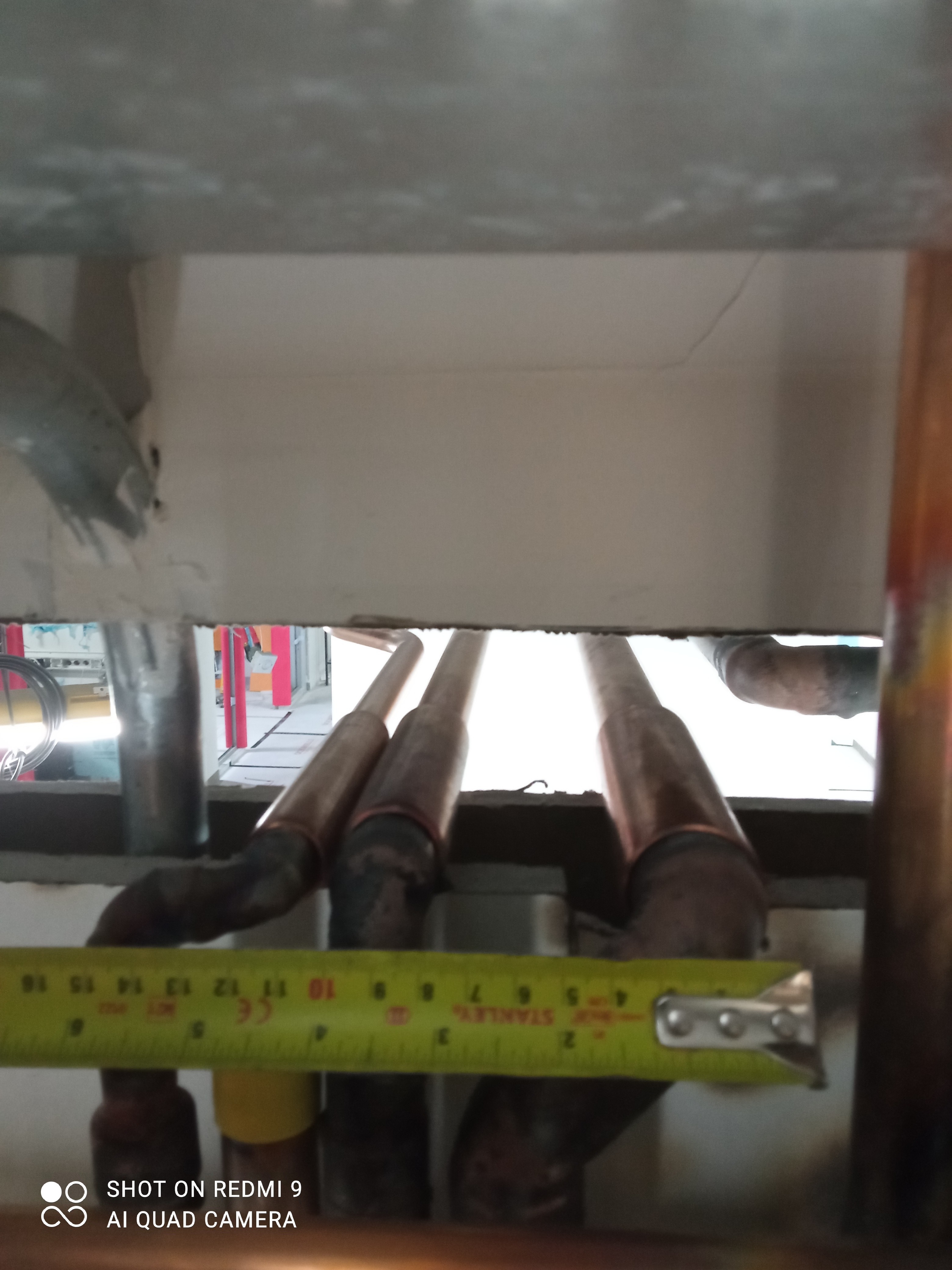

Hello...Have you any details about allowable service spacing distances going trough a drywall?i have some medical copper gas pipes and they don.t have any space between them...can.t use face fix installation because they are top close from the wall and i cant form a proper letterbox because there are conduits inside the wall...Are there special details for copper gas pipes or just the usual one for copper pipes?

Thanks for the question. We don't have any special standard details for medical pipes however we may be able to assist you. I'd suggest contact your local HILTI sales organisation and send the details along with the required fire resistance, pipe diameters and also the wall composition and thickness.
