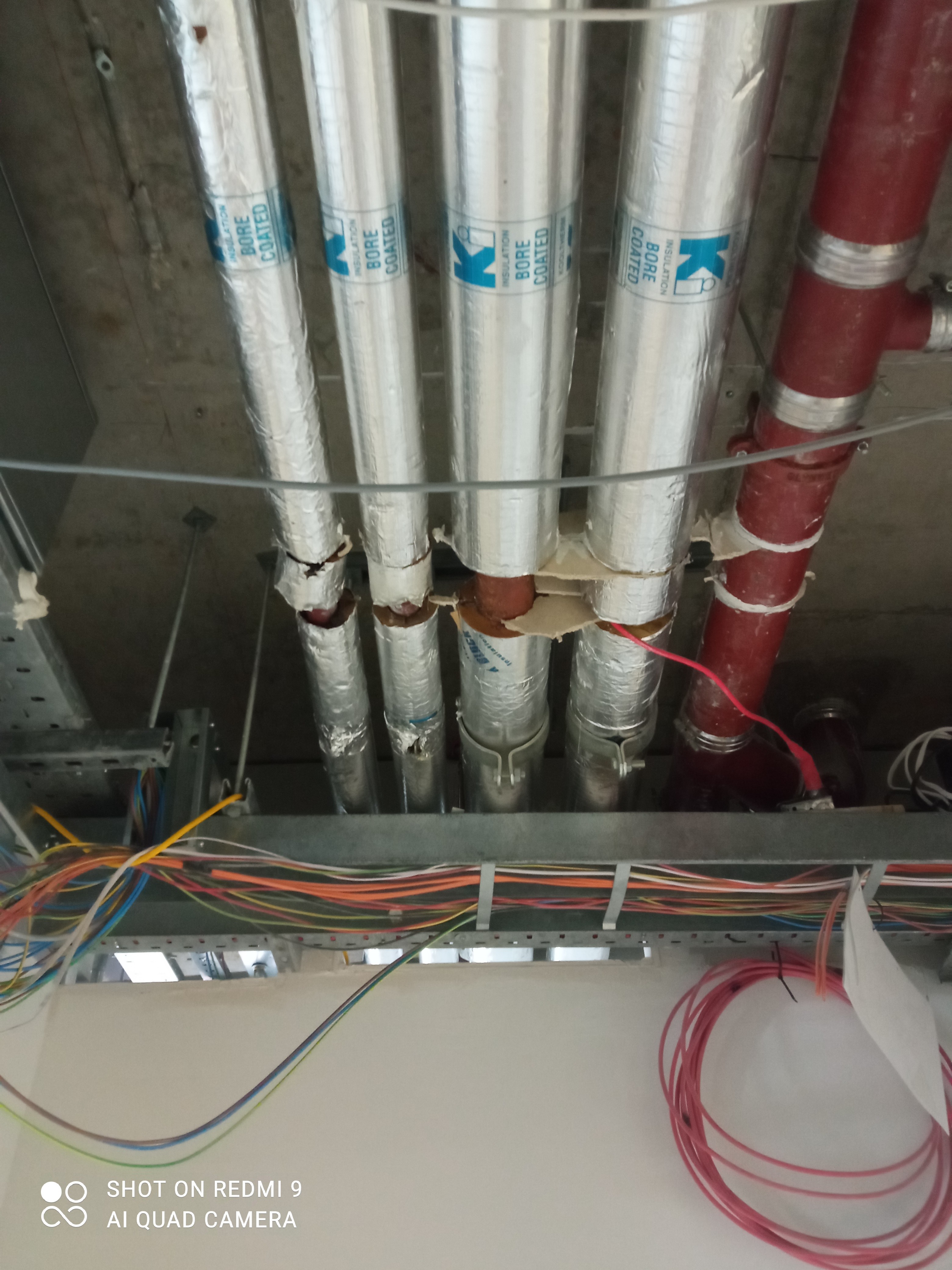

Hello.How can i fire stop steel pipes lagged with kingspan koolterm going trough fire batt?thank you
Steel pipes lagged,Copper pipes lagged with mineral wool

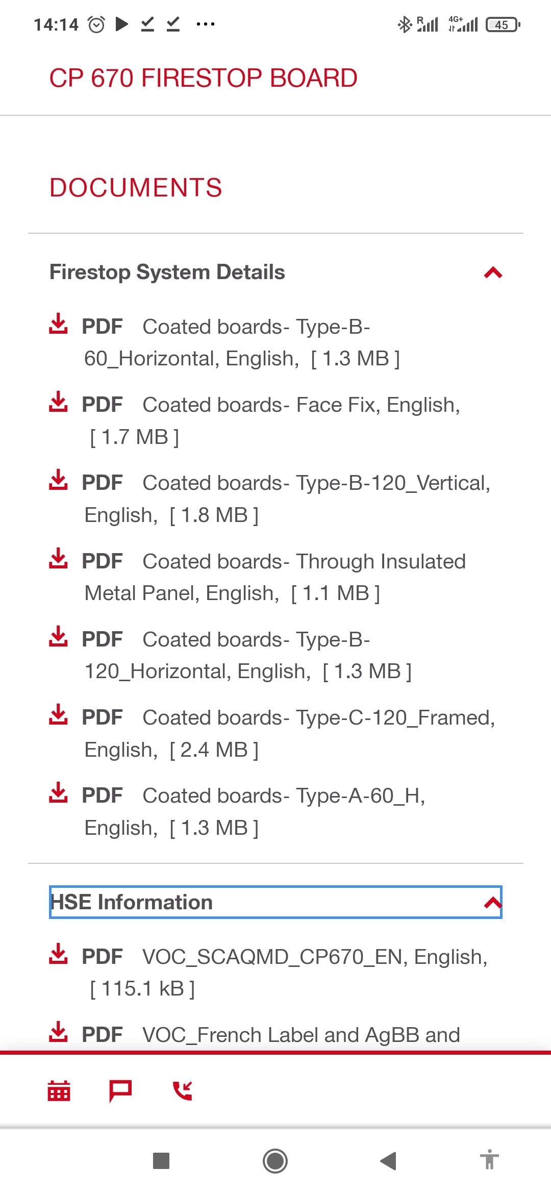

Thanks for the question. Please visit the HILTI website (HILTI.co.uk ) and look under the CP670 Board. There you will find standard details which includes vertically installed boards that covers insulated and non insulated non combustible pipes, spacing and service support distances etc
Posted by Christianover 4 years ago
Hello.I looked there but for vertical installation i found details only for type B 120 wich is two layers.For single layer are the same details?Thank you
1 comment on this reply
Hi, Apologies it seems all files have not yet been uploaded if you'd like to email gbtas@hilti.com they will be able to assist you further.
