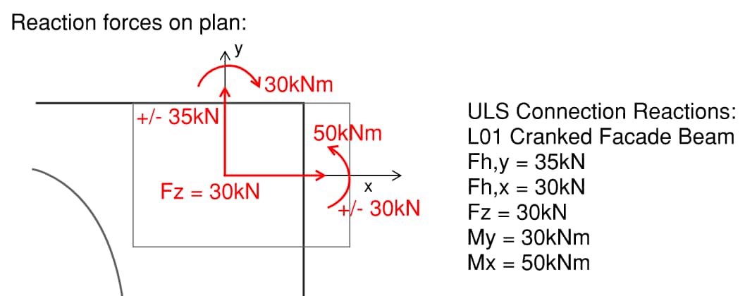

Edge connection failing. Any tips for designing with large moments and shears at edge of slab?
Posted by Sally Walshover 4 years ago

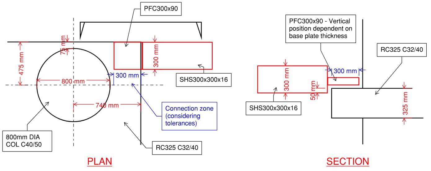

Designing connection of a steel facade beam to edge of concrete slab. Size of connection zone limited to 300mm due to concrete column nearby and construction tolerances. Steel facade beam is cranked creating a moment and shear force around both axis at connection. Currently connection in PROFIS is always failing in edge pull out. Please see attached images for forces and geometry constraints.
concrete edge breakout,combined shear and moment
