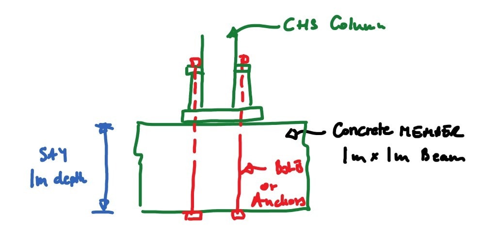

Can I choose higher grade and size or create custom bolt sizes? I am after large size dia bolt/anchors namely M75.
Also is there a possibility to join a column with a base plate into a horizontal concrete beam using anchors or bolts that pass through the concrete beam to the underside?
Joints,tension in anchor
Posted by Engineering Centre Teamover 3 years ago
Thank you for your question, in PROFIS Engineering it is not possible to custom create bolt sizes, this is due to the software running the calculations using data determined from tests and approvals. It is also not possible to model your through bolt situation in PROFIS Engineering, again this is down to the available products and test data that the software utilises.
