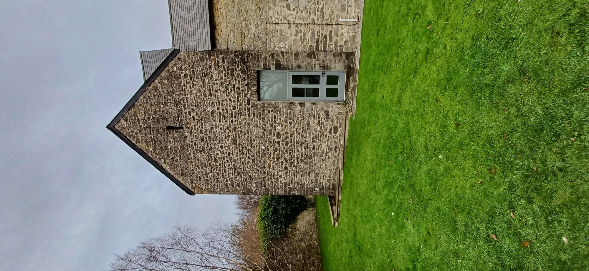

From the photo, a pole mount design is to be mounted on to the stone wall fabric, outdoors. Which products are suitable please ?

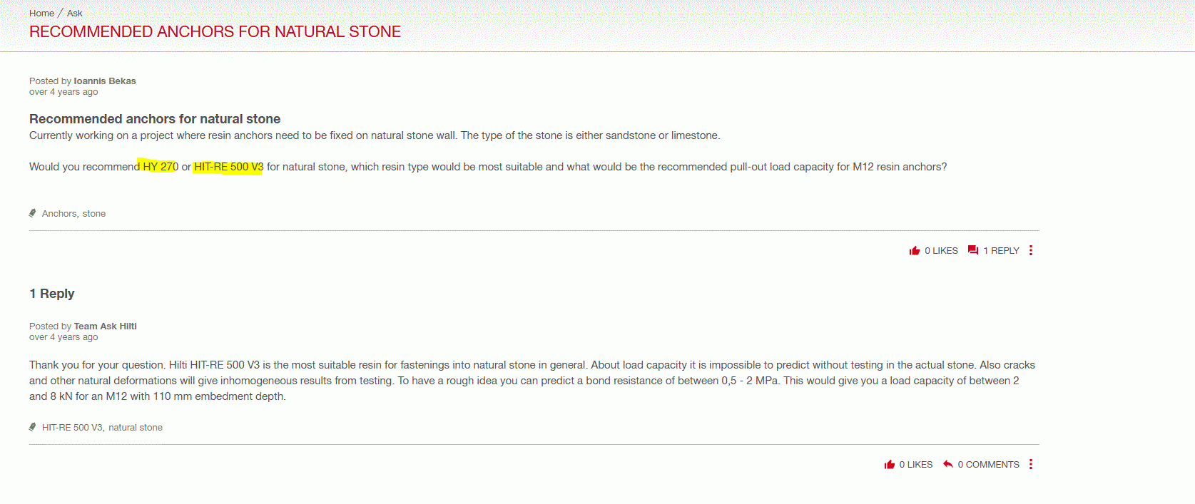

Hi, It will appear the resin design spec opinion for natural stone for the 2 products has changed over the last 4 years. Any specific reason for this ?
RE 500 cf HY 270
